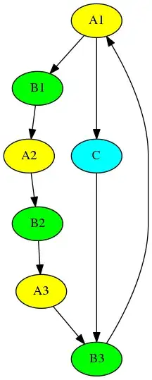

Let $G=(V,E)$ be a directed graph whose vertices $v \in V$ have colors and its edges $e\in E$ have costs $cost(e)$.
I am looking to find a set of vertex-disjoint cycles that:
  1. First maximizes the number of differently colored covered vertices.
  2. In case of ties, break ties by secondly maximizing the number of chosen edges.
  3. In case of any further ties, third minimizes the total cost of the chosen edges.
Original Graph
This is very similar to this problem, with additional constraint (#1). Without the first constraint (maximize the colors) this problem is easily solved by:

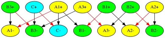

  • Splitting each vertex $v$ to $v^+$ and $v^-$.
  • Each vertex $v^+$ and $v^-$ provides a supply of $+1$ and $-1$, respectively.
  • Replacing an original edge $e': v \to w$ with $e: v^+ \to w^-$. Such each edge has cost $cost(e') = cost(e)$ and unit capacity.
  • Adding a "bind" edge $e'' : v^+ \to v^-$. Its cost is $c(e'') \gg 1$
Here is a representation:
Solution without color constraint
And the problem has been reduced to a minimum-flow problem (MCF). A MCF algorithm will choose $A_1 \to B_1 \to A_2 \to B2 \to A_3 \to B_3 \to A_1$.
My question: is it possible to apply a similar modeling to satisfy the color constraint in polynomial time? If so, is it possible to reduce the problem to a MCF problem?

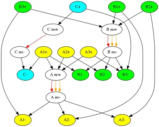

Here is how far I have managed to take it:
Attempt with color constraint
Here, bind-edges $e''$ go through a collective set of nodes, one per color, e.g., "A no+" and "A no-". These represent the corresponding vertices not chosen. Between "A no+" and "A no-" three edges are added with unit capacities and costs $ c(e_{red}) >> c(e_{orange}) >> 1$
I basically model that the cost of not choosing one or even two yellow items is insignificant to the cost of not choosing all three yellow items. Therefore, the goal is to choose $A_1 \to C \to B_3 \to A_1$.
Nevertheless, this did not quite work. Basically, if a flow goes through $A_1^+ \to A_{no}^+ \to A_{no}^-$, it's not guaranteed that it will return to $A_1^-$.
I have tried other approaches, including toying around with non-unit capacities, but I didn't find a solution. Can it be solved in polynomial time?
