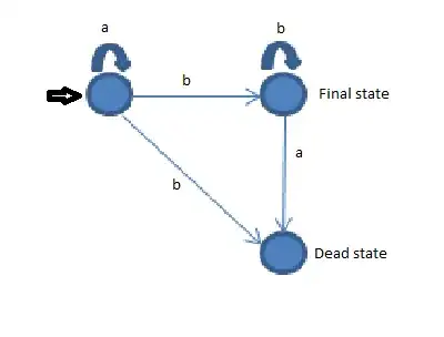

Any language for which you can develop a DFA.
Just check if you can draw a DFA for both of those languages.
$L_1={a^∗b^∗}$
$x^*$ denote all occurance of the alphabet $x$
Strings: $\epsilon$, a, b, aa, ab, bb, ..
To generate set of string belonging to $L_1$, machine need not to keep track of the number of a's and b's. As FA can remember only the last alphabet processed, DFA can be developed.
DFA exist.
Therefore regular.
