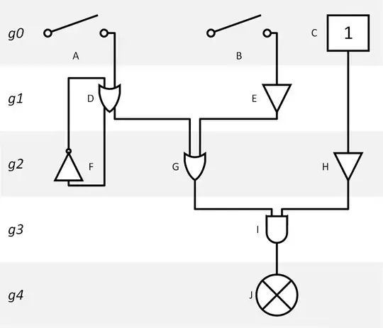

I'm performing a simulation of protein-protein interactions. I'm using Python to code logic gates as functions to model protein interactions. My model is basically a series of groups (g0 to g4) containing logic gates (see image). Initially, I set up a list containing my groups, and then for each group a dict that contains proteins (nodes) with their starting values (their so-called seedValues, which are the starting parameters for the network at $t=0$).
My question is this: is there some way of iterating through my groups (and their logic gate functions), that begins at group 0 (g0 in the image) at t, and that at t=t+1 executes groups g0 and g1 synchronously, then executes the three groups g0, g1 and g2 at t=t+2, and so on until t=m, where m is the number of iterations wanted?
logic gate iterator Image notes: A and B are switches (the program is supposed to change them, as a way of studying perturbations), C is a constant (never changed). J is the output (mostly for show). D and F are built that way to oscillate, whenever A = 0.
