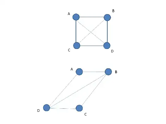

As part of a larger problem, I am trying to detect based on the distance matrix which segments intersect in the original 2D space that originated the matrix. I don´t have coordinates (lat/long, x/y or any other for the points).
As an example, on the image below, the answer to the question for the top graph would be: AD, BC. While for the bottom graph would be AC, BD.
The information that we have is just the distance matrix:
DISTANCE MATRIX TOP
$ \begin{align} && A && B && C && D \\ A&& 0 && 1 && 1 && \sqrt{2} \\ B&& 1 && 0 && \sqrt{2} && 1 \\ C&& 1 && \sqrt{2} && 0 && 1 \\ D&& \sqrt{2} && 1 && 1 && 0 \end{align} $
DISTANCE MATRIX BOTTOM
$ \begin{align} && A && B && C && D \\ A&& 0 && 1 && 1 && \sqrt{2} \\ B&& 1 && 0 && \sqrt{2} && \sqrt{5} \\ C&& 1 && \sqrt{2} && 0 && 1 \\ D&& \sqrt{2} && \sqrt{5} && 1 && 0 \end{align} $
I have tried so far to use the triangular inequality and some other (probably) naive geometric knowledge but I can´t figure out what conditions must be met.

First assume that you know where $A,B,C,D$ are. In this case, you can write $D$ uniquely in the form $\alpha_A A + \alpha_B B + \alpha_C C$, with $\alpha_A + \alpha_B + \alpha_C = 1$. The tuple $(\alpha_A,\alpha_B,\alpha_C)$ are called the barycentric coordinates of $D$. You can read off which of the segments $Dx$ ($x\in \{A,B,C\}$) cross a side of the triangle $ABC$ from the sign pattern of the barycentric coordinates.
It's not particularly difficult to find suitable coordinates either. You can just assume that $A=(0,0)$, $B=(d(A,B),0)$, and $C$ is either intersection point of the appropriate circles around $A$ and $B$. This will then uniquely determine $D$ by intersecting three circles.
