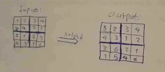

I couldn't figure out an algorithm for following graph coloring problem:
Output color of each vertex for this graph:
Given a solved 9*9 sudoku board that is a 9-colored board, applied first three rules below( a 4*4 one is in the picture as example),
Output a new k-coloring(k > 9) for the graph made from the input when we also applied rule number four.
Edge incidence rules:
1. There exists an edge between every pair of cells that are in the same row.
  1. There exists an edge between every pair of cells that are in the same column.
  2. There exists an edge between every pair of cells that are in the same 3*3 square.
  3. There exists an edge between every pair of cells that have the same label in the input board, that is an edge connects every cell labeled with number 1 to every other cell with the label 1, and every 2 is connected to any other 2s, and ... enter image description here Edit:
    I wondered whether there is an algorithm with tighter upper bound on k than the usual greed algorithm or not.
    (The greedy algorithm's upper bound on k is maximum of degrees of vertices of the graph plus one)
    Till now I just figured out that the subgraph that contains each color in the input is a clique when the rule four applied, That is there is a clique with vertices labeled 1, a clique with vertices all labeled 2, and so on.Since there is an edge between every pair of vertices with the same label so they are all connected, thus we have a complete subgraph, i.e. clique.
