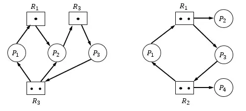

I was reading about deadlocks in Operating Systems. Where I came across two examples below.
Circles with label $P_x$ are processes. Squares with label $R_x$ are resources. Each dot in the square represents single instance of resource type $R_x$. An edge from $R_x$ to $P_x$ means an instance of resource $R_x$ is allocated to process $P_x$. An edge from $P_x$ to $R_x$ means the process $P_x$ is waiting for getting an instance of resource $R_x$ allocated.
Now consider below two resource allocation graphs
The example on left involves deadlock while the one on the right did not involved deadlock.
I can understand that in right-side figure, if $P_2$ releases its instance of $R_1$, it can be assigned to $P_1$, breaking the circular wait. Or if $P_4$ release its instance of $R_2$, it can be assigned to $P_3$, breaking the circular wait. However we cannot break circular wait in left-side figure.
While I can try out this on any given resource allocation graph and decide if there is deadlock or not, I want to know can we have a generalized rule for this which can tell what exactly it is which is contributing to the deadlock, especially in case of multiple instances of resources are there. I did not found any reference / book speaking of this clearly. So after a bit of thinking I came up with following fact:
If there are multiple instances of same resource, for deadlock to exist, for any combination of two processes, if both are allocated an instance of same resource, then both should be a part of at least one cycle.
In right-side figure above, there is no deadlock because
  • processes $P_2$ and $P_3$ are allocated instances of $R_1$, but they both are not part of any cycle
  • similarly processes $P_1$ and $P_4$ are allocated instances of $R_2$, but they both are not part of any cycle
In left-side figure above, there is a deadlock because
  • processes $P_1$ and $P_2$ are allocated instances of resource $R_3$ and are part of same cycle,$P_1-R_1-P_2-R_3-P_3-R_3-P_1$
So am I correct with the above realization of fact? Or there are more aspects/conditions to the above fact (of when deadlock is present and when not) that I am missing?

All 4 conditions must be satisfied at the same time.
  • Hold and Wait
  • Non-preemption of resources
  • Mutual Exclusion
  • Circular wait
In case of single instance of resources:
Cycle in resource allocation graph represents deadlock.
In case of multiple instance of resources:
Cycle in RAG doesn't mean deadlock. You must check in the same way as you did. Let me write clear steps.
  • We need to identify a process, in the cycle, which can execute without any dependency and execute that.
  • Release the resources held by process.
  • Next check the process which has all the resources to execute and execute completely and release the resources held by it.
  • Keep doing till all the processes are executed.
  • If you can't execute all the processes this way, then there is deadlock.
Hope that helps!
Your logic follows, and falls in line with the need for a circular wait in a deadlock.

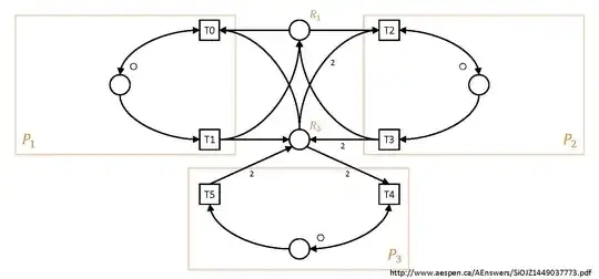

Assuming there is enough resources, one way to prevent a deadlock is for a process to release the resources it has taken if one or more of the other resources it needs are not available. Another way to prevent a deadlock would be for a process allocate the resources it needs only if all of the resources it needs are available; otherwise, the process should not allocate any of the resources. The Petri Net in Figure 2 was designed this way – resources are allocated at the same time to a process if and only if every resource needed by the process is available.
Figure 2: A Petri Net Model for Allocating Resources without Deadlock
