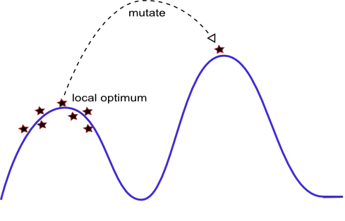

Neural networks are known to be capable of universal function approximation, but this requires training them on the problem (optimization) which is a NP-complete problem in and of itself, which is why you have evolutionary training and SGD with backpropagation and so on.
So while they are not likely to solve NP-complete problems they can be trained to approximate to an arbitrary degree of accuracy a function that models the problem. Also even if you happen to solve an NP-complete problem optimally using a neural network you still have no way to prove that the solution it found is actually the global optimum without brute forcing the solution (this is of course not feasible for almost any practical use case of neural networks).
Your visualization is accurate in the sense that evolutionary algorithms (see how the neat algorithm prevents a single species from taking over the population with an initially highly performant structure by using shared fitness) are less apt than SGD and other machine learning techniques to be trapped in local optimums but they provide no proof that the solution they find is in fact the global optimum solution.
