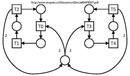

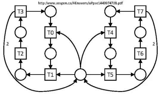

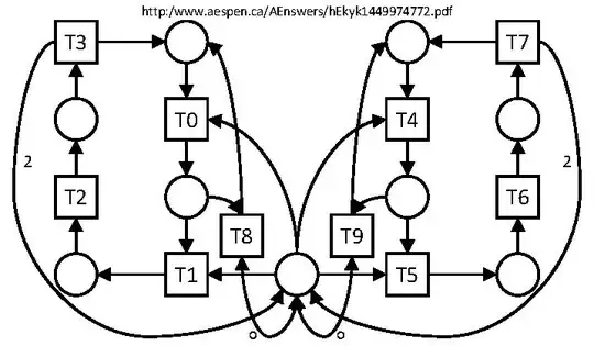

Consider using a Petri Net for the system design. In terms of Petri Nets a deadlock is a situation when no transition is enabled. Figure 1 is an example of a system that may enter a deadlock state. In this example, m=2 and n=2. For the same number of processes and resource needs per process (m=2 and n=2), it is also possible to create a system that does not enter a deadlock state. Each of Figure 2 and Figure 3 is an example of two systems that will never reach a deadlock state.
Figure 1: A System with Deadlock A System with Deadlock
Figure 2: A System without Deadlock A System without Deadlock
Figure 3: Another System without Deadlock Another System without Deadlock

For Figure 1, the transitions related to Process 1 (Process 2) are:
  • T0 (T4) – get 1 resource unit.
  • T1 (T5) – get 1 resource unit.
  • T2 (T6) – process critical section.
  • T3 (T7) – return 2 resource units.
For Figure 2, the transitions related to Process 1 (Process 2) are:
  • T8 (T9) – return 1 resource unit.
For Figure 3, the transitions related to Process 1 (Process 2) are:
  • T0 (T3) – get 2 resource units.
  • T1 (T4) – process critical section.
  • T2 (T5) – return 2 resource units.
