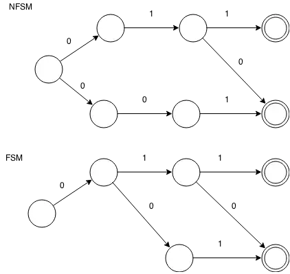

I gave it a little more thought, this part of my question:
"NCAs can't be equivalent to CAs [..] possibly exponential growth of the required states doesn't fit to the CA definition"
is false. The number of states doesn't matter, It would still be the same lattice. E.g. Let $A$ be a CA on $Z$. The state of a cell $q$ is either $0$ or $1$, all cells are $0$ at first. Each cell sees only it's direct neighbours. Then consider this state transition function $\delta$:
| $q_l$ | $q_t$ | $q_r$ | $q_{t+1}|
|   0   |   0   |   0   |   0     |
|   0   |   0   |   1   |   1     |
|   0   |   1   |   0   |   1     |
|   0   |   1   |   1   |   1     |
|   1   |   0   |   0   |   0     |
|   1   |   0   |   1   |   0     |
|   1   |   1   |   0   |   0     |
|   1   |   1   |   1   |   0     |
It doesn't matter whether I would describe this as a DFSM or NFSM, as long as both accept the same input string, e.g. $q_lq_tq_r$. Here is a NFSM and a DFSM version describing $\delta$, both accept the same string, accepting means $q_{t+1}$ will be 1, else 0.
Not drawn input combinations end in a rejecting state. While this is no proof I think it intuitively shows that CAs and NCAs are equivalent.
