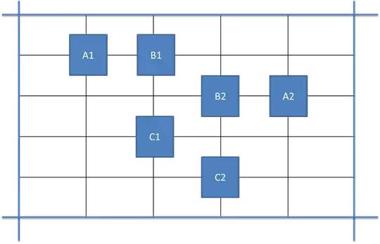

UPDATE: I am given a geometry problem - i have a rectangular tile that should be filled with a set of various objects. Some configurations of objects are prohibited (it does not matter why). Each rule is populated in every applicable point of a tile: enter image description here $$\psi = \neg (A_1 \wedge B_1 \wedge C_1) \wedge \neg (A_2 \wedge B_2 \wedge C_2)$$

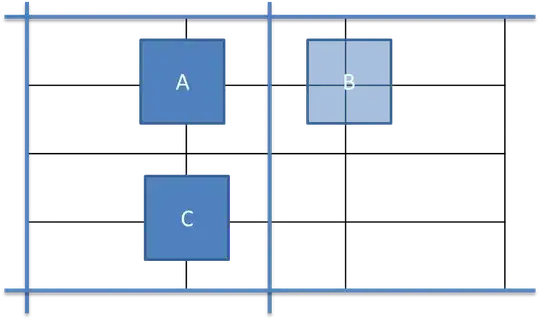

Blue bold lines are tile's borders. Such configuration of objects is prohibited: $$ \neg (A \wedge B \wedge C) 4)$$ This fact is represented as a set of clauses. $\psi$ forms a SAT task. You can think of it like "SAT, find me a tile which does not have any of these prohibited configurations". And this is my core formula. The same rule in different points of tile forms an identical set of clauses, but over different variables, e.g. $A_1, B_1, C_1$ and $A_2, B_2, C_2$ in the formula above - one rule forbids a set of 3 objects in 2 different points.

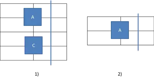

At the same time, such rules can be partially outside a tile (pay attention to the right side border). The object outside is transparent: enter image description here
This is prohibited too. The issue is that SAT solver does not know anything about world outside a tile, there is literally nothing out there. However, I still need to capture such configurations. I take each core rule and split it with boundary: enter image description here $$\neg(A \wedge boundary) 5)$$ $$\neg(A \wedge C \wedge boundary) 6)$$

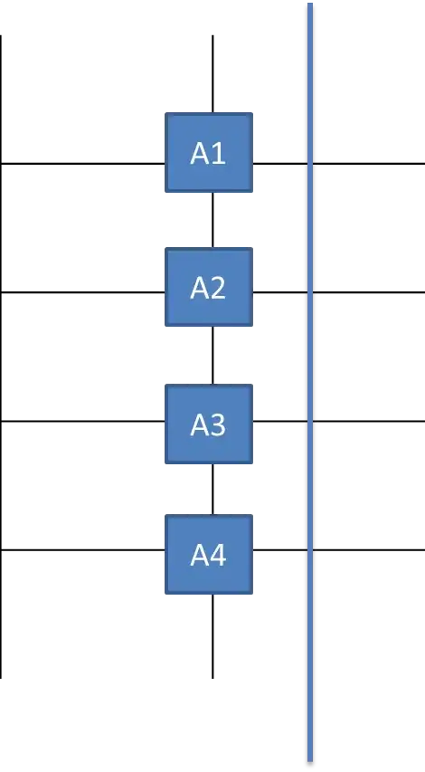

Over the whole tile it looks like this: enter image description here
If we choose 5) rule, we will prohibit all obects $A$ near the boundary: $$\psi = \neg (A_1 \wedge boundary) \wedge \neg (A_2 \wedge boundary) \wedge \neg (A_3 \wedge boundary) \wedge \neg (A_4 \wedge boundary)$$
However, we can choose 6) rule: $$\psi = \neg (A_1 \wedge A_2 \wedge boundary) \wedge \neg (A_2 \wedge A_3 \wedge boundary) \wedge \neg (A_3 \wedge A_4 \wedge boundary)$$ This option is much better - it prohibits 2) rule near the boundary already and at the same time it allows to place single $A$ object near the boundary.
