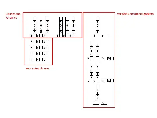

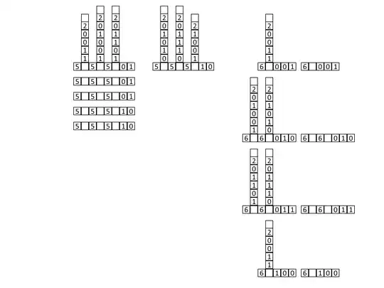

Example
If the previous explanation was confusing, here is an example picture of an instance of positive 1 in 3 SAT that has been reduced to this word problem:
Example board
If we disallow repeated words:
Example board, no repeats
The instance that has been reduced is:
$(x_1 \lor x_2 \lor x_3) \land (x_2 \lor x_3 \lor x_4) $

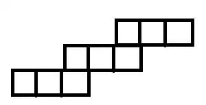

I think the following reduction from Directed Hamiltonian path works:
Given a graph $G=(V,E)$ and a two vertices $s,t\in V$, we output the following puzzle:
The alphabet is $V\cup \{*\}$, with $*$ being some symbol not in $V$.
The words are $v*v$ for every $v\in V$, and $vu$ for every edge $(u,v)\in E$.
The board consists of two parts. The first looks like $|V|$ horizontal "stairs" of length 3, stacked on top of each other, as depicted here:
stairs
The second part consists of $|E|-(|V|-1)$ disjoint spaces of length 2.
Also, we set in the first (bottom) step of the stairs the word $s*s$ (and remove it from the word list), and in the last step we put $t*t$.
Now, in order to fill the stairs, only vertex-words can be put within the steps, and in order to connect two vertices, an edge word must be put between them, which corresponds to an existing edge in the graph. The unused edges can be put in the second part of the board. The second direction is trivial.
I think this works (the correctness proof I sketched is hand-waved at best, but still).
