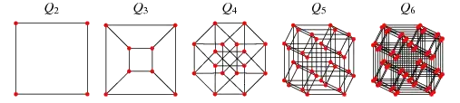

Partial answer on uniqueness: 3-connectedness is not sufficient.
Minimal counter example: cube graph ($Q_3$ of the Hypercube Graph family)
To see how fixing the length of all edges in $Q_3$ does not give positions to vertices in 3-d space that is unique up to translation/rotation/mirroring, look at how you can flatten a cardboard box (with 2 opposing faces removed).
Take the corners of cardboard box to be the vertices of interest. Each corner of a cardboard box have fixed distance from other corners which it shares a box's face with.
While the resulting graph has even more edges than $Q_3$, it still allows the cardboard box to be flatten down --- a transformation which can not be produced by translation/rotation/mirroring.
