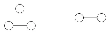

Given the various misunderstandings indicated by the comments, here are some pictures to illustrate these concepts. If you have an idea for an easier to understand terminology (instead of "cover", "equivalence relation", "disjoint union of cliques" and "not necessarily disjoint" union of edge sets), feel free to let me know.
Here is a picture of a graph and one equivalence relation covering it: graph and one equivalence relation covering it
Here is a picture of a graph and two equivalence relations covering it: graph and two equivalence relations covering it
It should be pretty obvious that at least two equivalence relations are required.

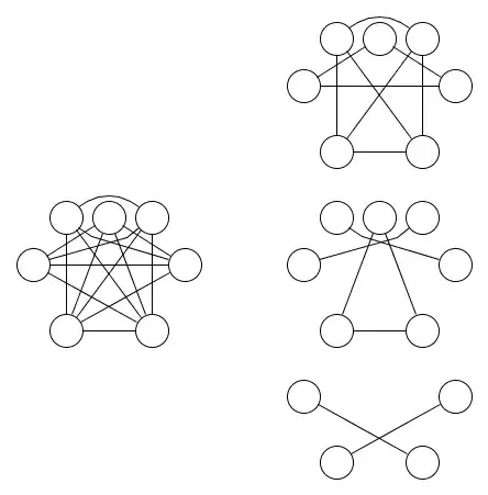

Here is a picture of a graph and three equivalence relations covering it: graph and three equivalence relations covering it
It's less obvious that at least three equivalence relations are required. Lemma 1.9 from Dual of the Logic of Subsets can be used to show that this is true. The generalization of this lemma to nand operations with more than two inputs was the motivation for this question.
