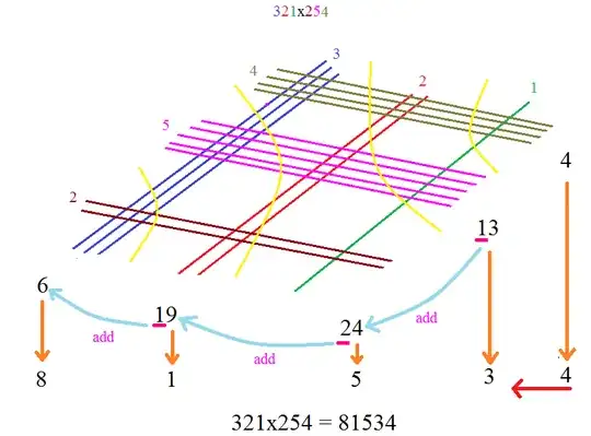

On SuperUser, I asked a (possibly silly) question about processors using mathematical shortcuts and would like to have a look at the possibility at the software application of that concept.
I'd like to write a simulation of Japanese Multiplication to get benchmarks on large calculations utilizing the shortcut vs traditional CPU multiplication. I'm curious as to whether it makes sense to try this.
My Question: I'd like to know whether or not a software math shortcut, as described above is actually a shortcut at all.
This is a question of programming concept. By utilizing the simulation of Japanese Multiplication, is a program actually capable of improving calculation speed? Or am I doomed from the start?
The answer to this question isn't required to determine whether or not the experiment will succeed, but rather whether or not it's logically possible for such a thing to occur in any program, using this concept as an example.
My theory is that since addition is computed faster than multiplication, a simulation of Japanese multiplication may actually allow a program to multiply (large) numbers faster than the CPU arithmetic unit can. I think this would be a very interesting finding, if it proves to be true.
If, in the multiplication of numbers of any immense size, the shortcut were to calculate the result via less instructions (or faster) than traditional ALU multiplication, I would consider the experiment a success.

The method shown in the picture is essentially the same as the standard algorithm (long multiplication) taught in many schools. Since this way of doing multiplication is common knowledge, I don't expect it would help you speed up multiplications on a computer... unless you think the idea of performing small multiplications with overlapping lines would somehow be faster than normal circuit design.
To see why this method is the same as long multiplication, let's say we're multiplying abc * def. With Japanese multiplication, you compute five numbers: cf, bf+ce, af+be+cd, ae+bd, and ad. Then you add them together, adding the tens digit of each to the ones digit of the next, to produce the sum cf + 10(bf+ce) + 100(af+be+cd) + 1000(ae+bd) + 10000ad.
Compare this to long multiplication. You first compute the three numbers cf+10bf+100af, ce+10be+100ae, and cd+10bd+100ad. But the second number is shifted to the left by one digit, and the third number by two. So when you add them, you get (cf+10bf+100af)+10(ce+10be+100ae)+100(cd+10bd+100ad), which is equivalent to the answer we got from Japanese multiplication.
