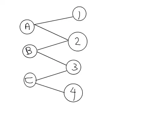

I have a variant of bidding problem at hand. There are N bidders(~20) who bid for items from a pool of many items(~10K). Each bidder can bid many items. I want to maximize the number of bidders who are satisfied. A bidder is satisfied if he gets all the items that he bid for in the first place. For eg-
Bidders = A,B,C
Items = 1,2,3,4
Bidder    Bids
A         1,2
B         2,3
C         3,4
enter image description here In this case its only possible to satisfy 2 bidders at max.
