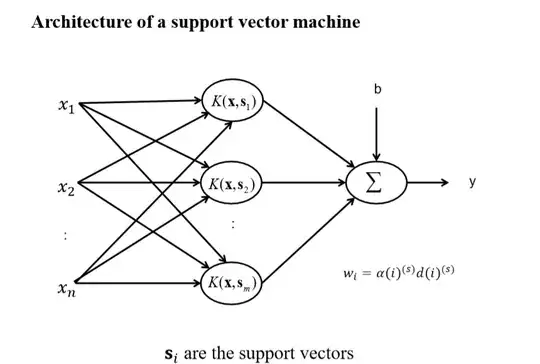

some says it is because of this architecture SVM is comparable to neural nets
