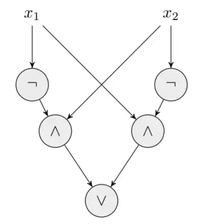

A boolean circuit C has n inputs and m outputs, and is constructed with AND, OR, and NOT gates. Each gate has fan-in 2 except the NOT gate which has fan-in 1. The out-degree can be any number. A circuit is not allowed to have any cycles.
For example construction of a circuit C computing the XOR function, i.e., $C(x_1, x_2) = 1 \iff x_1\neq x_2:$
