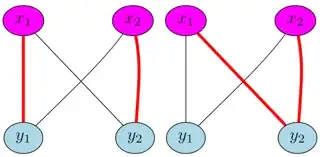

Given a bipartite graph G=(X,Y,E) and consider the b-matchings where each X-node is matched with at most one Y-node and each Y-node is matched with at most 2 X-nodes.
Is there a polynomial-time algorithm to find a b-matching with maximum cardinality (# of edges) and given that, the smallest number of distinct Y-nodes among these b-matchings?
In both figures below, the red edges form a valid maximum b-matching. However, the right one is the desired since it has only one Y-node ($y_2$) while the left one has two ($y_1$ and $y_2$).
