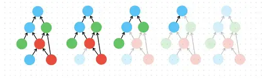

Take a directed acyclic graph where every vertex is given a non-unique label 1..N
You can ‘trim’ the DAG by making a cut that removes all vertices that share one label and also don’t have any ancestors of a different label. Repeat until the DAG is empty.
I’m trying to find an efficient algorithm that finds the minimal number of trims. I'm looking for algorithms that find the correct optimal answer, rather than heuristics.
Below is an example of the process.
  • Start with the DAG on the left
  • Trimmed blue that don't have non-blue ancestors
  • Trimmed all red since now both don't have any non-red ancestors
  • Trimmed all green since now they don't have any non-green ancestors
  • Trimmed the remaining blue that now don't have non-blue ancestors trimming example This is the optimal trimming order in this case.
If instead you started by trimming red first you could only remove one red vertex (the one that doesn't have a blue ancestor) and you would end up with more trimming steps.
