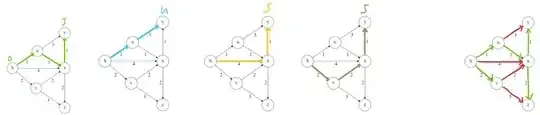

I will tell you where I got stuck:
Here is an example for a graph I tried to work with
It can be shown that each edge on the shortest path between $s$ to $y$, is the shortest edge between two nodes in the path. I can't see the point when Dijkstra's algorithm gives the second shortest path (if it does at all).
In order to get the second shortest path, I know that one green edge on the left need to be removed, but I don't know which one, and that's why I used the loop in line 6.
