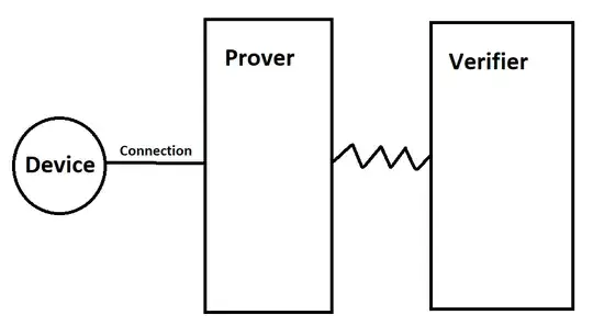

I have a conundrum to solve but am not knowledgeable enough about cryptography to know whether it's possible to do, and if so, what method to use.
I am a Provider and my task is to prove to some outside Verifier the existence of a Connection to some device, beyond some reasonable probability $\epsilon$. The Verifier and the Prover have a communication channel and can ask each other questions. As a Prover, I could lie at any point, and pretend the Connection exists when it doesn't, or vice versa. I need a protocol that is secure in such a way that the Verifier can establish the Connection is genuinely there.
Question 1: Is there any such protocol that could do with with communication and computation on the Prover side alone?
Question 2: In case the former isn't possible, if the Device could do some computation (i.e. do (modular) arithmetic etc.) and the Connection could be used for that, would that make this possible?
Diagram
I feel there are some cryptographic algorithms out there that are designed for this, but I don't quite know what they are. I have looked into Zero-Knowledge proofs, but all the examples I find aren't quite suitable to this kind of issue.

The Verifier must encrypt a message using the public encryption key of the device and ask the Prover to decrypt it. (Nobody knowing the private key.)
