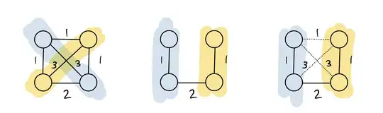

Here is an example:
The graph on the left is the original graph. All nodes have the same weight. If I want to partition the graph into two components, while enforcing contiguity constraints, I would choose the highlighted groups. This partition has a "cost" of 5. But what I actually want to do is partition the graph on the left, while enforcing the constraint that each component be contiguous if it only had the edges in the graph in the middle. This obviously results in a different partition (which is actually the only feasible partition in this small example). This partition has a cost of 9 (note I am still counting the edges from the original graph), but it satisfies the constraints.
