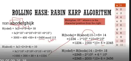

How Rolling Hash is used in our class with a given formula and its process of solution: rolling hash
Formulas:
form1 form2

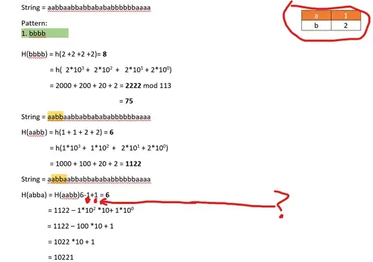

My attempt for pattern "bbbb" by using the "String = aabbaabbabbabababbbbbbaaaa": what
Not picture form:

H(bbbb) = h(2 +2 +2 +2)= 8 = h( 2103 + 2102 + 2101 + 2100) = 2000 + 200 + 20 + 2 = 2222 mod 113 = 75
H(aabb ) = h(1 + 1 + 2 + 2) = 6
= h(1103 + 1102 + 2101 + 2100) = 1000 + 100 + 20 + 2 = 1122
H(abba) = H(aabb)6-1+1 = 6
= 1122 – 1102 10+ 1100 = 1122 – 100 10 + 1
= 1022 *10 + 1 = 10221
I am now quite unsure with the -1 and +1 that I have annotated, in which these values involve the character present from the previous pattern but is now absent from the current pattern( - 1(where a is 1), and +1 where it is the character found from the current pattern but is absent to the previous pattern(still a).
I considered these a's because of their specific position being different, thus for me, they are considered somewhat missing/unique in comparing between two patterns.
Am I doing the process right or should I not consider these conditions? Especially since the string patterns both contain only the occurrences of a and b as we traverse in finding the exact pattern into the given string that we are using.
I decided to stop the process first since I might be doing it wrong, especially since it may take a while to find the exact pattern string.

A clearer explanation
Let $\beta$ be a positive integer. ($b$ will be used as a character)
Let string $s=c_1c_2\cdots c_m$. Then $$H(s) = c_1\times \beta^{m-1} + c_2\times \beta^{m-2} + c_3\times \beta^{m-3} + \cdots + c_m\times \beta^0$$ where we abuse $c_i$ to also denote the number that encodes it. For example, $a=1$, $b=2$, etc.
$$\text{TEXT:}\quad**********\, \rlap{\,\overbrace{\phantom{C_{\text{prev}}*********\,}}^{\text{previous window}}} C_{\text{prev}}\,\underbrace{**********C_{\text{next}}\!}_{\text{next window}}************* $$

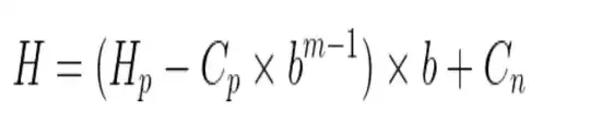

$$H_{\text{next}}=(H_{\text{prev}}-C_{\text{prev}}\times \beta^{m-1})\times \beta + C_{\text{next}}$$ where $*$ stands for a character. Each window consists of $m$ characters.
Let $m=4, \beta= 10$.
Pattern: $bbbb$
$$\begin{aligned} H(bbbb) &= 2*10^3 + 2*10^2 + 2*10^1 + 2*10^0\\ &= 2000 + 200 + 20 + 2\\ &= 2222 \end{aligned} $$ String = $aabbaabbabbabababbbbbbaaaa$
$$\begin{aligned} H(aabb) &= 1*10^3 + 1*10^2 + 2*10^1 + 2*10^0\\ &= 1000 + 100 + 20 + 2\\ &= 1122\\ H(abba) &= H(\not {\! \color{red}a} abb\color{blue}a)\\ &=(H(\color{red}aabb) - \color{red}a *10^3) * 10 +\color{blue}a\\ &= (1122 - \color{red}1*1000) * 10 + \color{blue}1\\ &= 1221 \\ H(bbaa) &= H(\not {\! \color{red}a} bba\color{blue}a)\\ &=(H(\color{red}abba) - \color{red}a *10^3) * 10 +\color{blue}a\\ &= (1221 - \color{red}1*1000) * 10 + \color{blue}1\\ &= 2211 \\ H(baab) &= H(\not {\! \color{red}b} baa\color{blue}b)\\ &=(H(\color{red}bbba) - \color{red}b *10^3) * 10 +\color{blue}b\\ &= (2211 - \color{red}2*1000) * 10 + \color{blue}2\\ &= 2112 \end{aligned}$$
