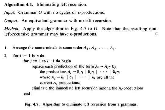

Now if we consider the algorithm given in the Compilers text by Ullman et. al
In the algorithm above, the authors are assuming the input grammar to be free from $\epsilon$ productions. Is it strictly necessary? Is there any specific case, where not following the algorithm strictly shall lead to wrong answers.
Application of the Ullman algorithm is easy, but it is increasing the number of productions, mainly due to the removal of the $\epsilon$ production

If a grammar includes nullable productions, then it may have hidden left recursion; a production such as $A\to N A \beta$ where $N$ is nullable. Such a production won't be removed by Ullman's algorithm, but it is nonetheless left-recursive. So it's usual to start by removing $\epsilon$ productions, thus guaranteeing that there are no nullable non-terminals and therefore that all left-recursion is visible.
There is no hidden left recursion in the grammar you are working on, but the easiest way to prove that is to remove the $\epsilon$ productions :-).
Sometimes it is possible to remove nullable productions without increasing the number of productions. You could do that with your grammar if you wanted to, but the easiest algorithmic solution is unlikely to find that modification.
