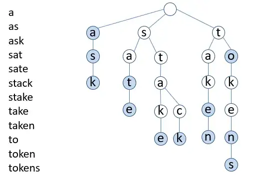

Step 1. Organize your dictionary into a giant trie
Let's say our dictionary consists of the 12 words shown below. The corresponding trie is shown to the right. We also want to keep track of which nodes are word endings, which I've given a solid blue color:
An example trie with 12 words

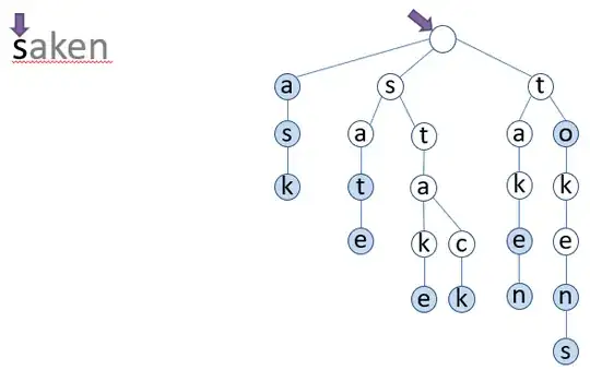

This list starts with one entry: (first letter, root of trie, 0), as shown below.
starting conditions of using a trie to check a misspelled word

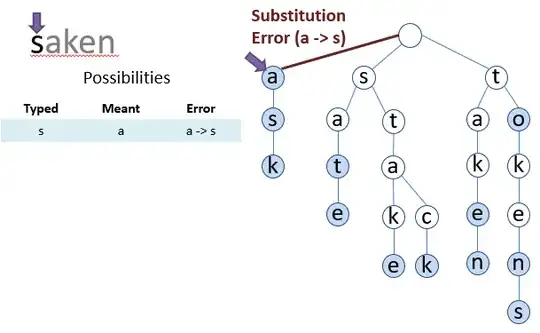

Given a starting 3-tuple as a seed, we add new elements to the list differently for each type of error (insertion, deletion, and substitution). For instance, when checking for substitution errors, we add an element for every child of our current trie node, with additional error based on the letters being substituted (taking into account surrounding letters as well). This is illustrated below for the "a" node, but we do the same for every other child. Of course, substituting "s" for "s" gets an error value of 0.
a substitution error

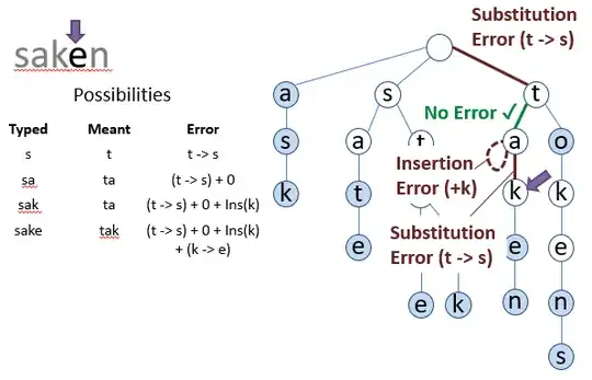

We always have a single possible insertion error, which is the letter we're currently on. In that case, the word-pointer moves forward, but the trie-pointer stays where it is. Deletions are the opposite: the word-pointer stays where it is, while the trie-pointer moves forward (to every child).
Here's an example traversal with mixed errors. Here we are considering the possibility that the user accidentally typed "s" instead of "t", then correctly typed "a", then accidentally inserted a "k", then accidentally type "e" when they meant to type "k". In reality, only the last row would be left in our list, but the others are left for illustration.
If we're using a simple Levenshtein distance error model, then our total error so far is 3.
Of course it's more likely that the user actually did mean "ke" at this point, but our job right now is to simply enumerate and score all the possible ways $w$ could have been typed instead of $c$.
