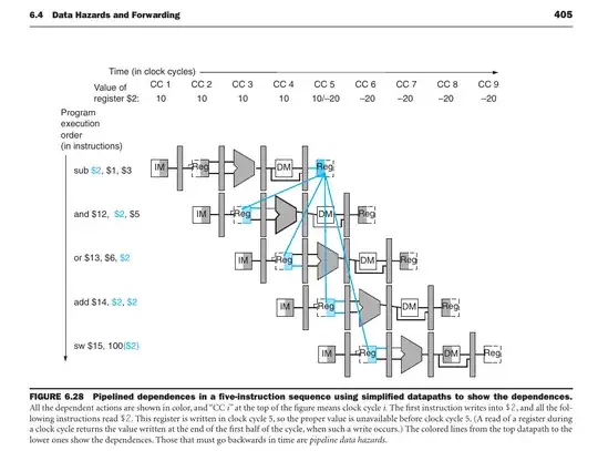

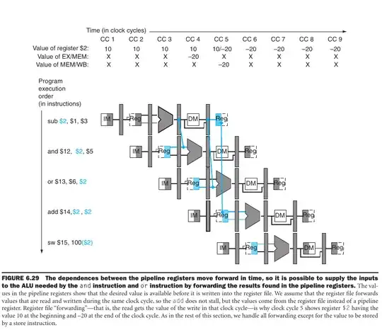

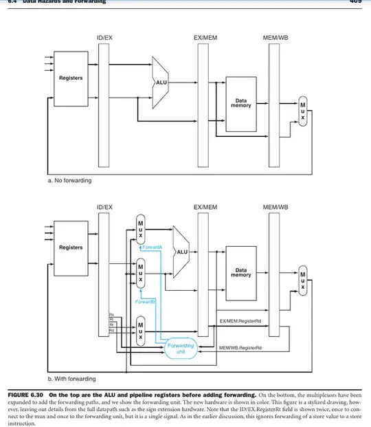

There was an exactly same question which was not clearly explained however, but there was an answer here. Where the author of the answer says that forwarding only makes sense from "perform operation" to "operand fetch". But I have read Computer Organization and Design: The Hardware Software Interface (3rd Ed.) , by Patterson et. al where they show how the operands are forwarded from various stages following the $EX$ phase to the inputs of the $ALU$ using $MUX$. $\text{(pgs 405,408,409)}$. The convention used in the Patterson book is clearly explained.
enter image description here The different dependencies being shown
enter image description here The dependencies resolved by operand forwarding
enter image description here The hardware showing how the operand forwarding is actually done
What is creating problem here is that the question says $PO$ to $OF$, which makes me naturally feel that we give the output of the $ALU$ to the inputs of the $OF$ (literal meaning guessed from the question and from how the operand forwarding is dealt with in the Patterson text).
Now in the solution to the question they are using some sort of split phasing which is used in Patterson, only for the register read phase and the register write back phase, to prevent structural hazard. How is the operand forwarding from the $PO$ phase to the $OF$ phase being executed? As the author here says that the data from the $ALU$ is written to the latch following the ALU and also to the latch following the $OF$ stage in a single cycle.. The effect being similar to the result of $ALU$ being forwarded to the inputs of the $ALU$. (The case explained in Patterson, though the hardware implementation is actually different.)
