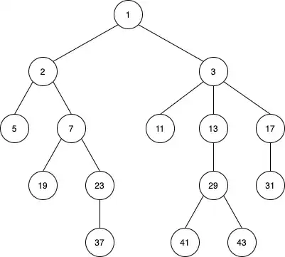

Example 1
Let's say we have the following graph and $k = 74$
example

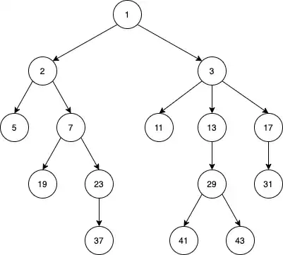

First, root the tree
rooted

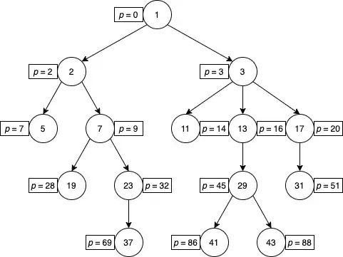

Second, compute partial sums
partialsum
Now we have:
$L = [2, 7, 9, 28, 32, 69]$
$R = [3, 14, 16, 20, 45, 51, 86, 88]$
Third, scan through $L$ and $R$ searching for $74 - 1 = 73$
  1. 2 + 88 = 90 > 73, decrement $r$
  2. 2 + 86 = 88 > 73, decrement $r$
  3. 2 + 51 = 53 < 73, increment $l$
  4. 7 + 51 = 58 < 73, increment $l$
  5. 9 + 51 = 60 < 73, increment $l$
  6. 28 + 51 = 79 > 73, decrement $r$
  7. 28 + 45 = 73!
We've found 73, so we know a path of value 74 starts where $p(s) = 28$ and ends where $p(t) = 45$. This path is: $[19, 7, 2, 1, 3, 13, 29]$.

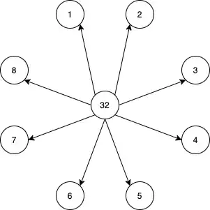

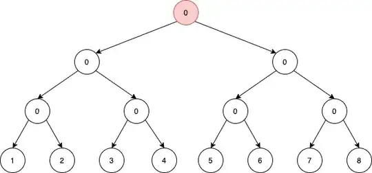

Root all trees as binary trees
When computing partial sums, since we are not including the root node, we can use this step and convert it into a binary tree (at least from the root's perspective) by adding at most a linear number of nodes.
If the root has $d$ children, then we create a balanced binary tree with $d$ leaves where the leaf nodes are those $d$ children and all other nodes are value 0. We compute the partial sums and follow that formula above to determine if it crosses the root node of this new tree.
For example:
star
Would convert to:
binary
Then the algorithm would tell you if the path spans the root node (in read) which really means "does this path go from the children [1, 2, 3, 4] to the children [5, 6, 7, 8]?". Then if the answer is no, you recurse on the following:
