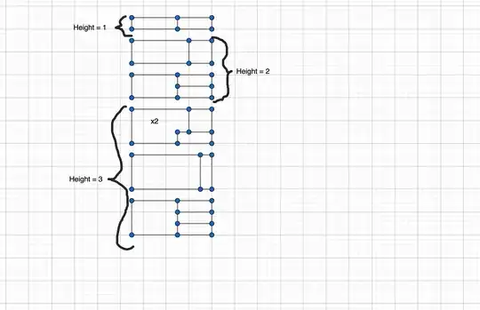

After a lot of thoughts and getting some ideas from answers, I came up with this solutions (Image represents a top down DP approach) enter image description here
Basically, based on the image,
  1. To get to 1xN state, we can take 1 time, 1x3 and so dpHeight1[n] = dpHeight1[n-3]
  2. To get to 2xN state, we can either take 1 time 2x2 so dpHeight2[n] = dpHeight2[n-2] or we can take 2 times 1x3: dpHeight2[n] += dpHeight2[n-3]
  3. to get to 3xN, we can either take 1 time 3x1, so dpHeight3[n] = dpHeight3[n-1] or we can take 3 time 1x3, dpHeight3[n] += dpHeight3[n-3] or take 1 time 2x2 and 1 time 1x3, exception here is we can take 1x3 first or after we take 2x2, but they both have same count, so: dpHeight3[n] += (dpHeight1[n-3] * dpHeight2[n-2] * 2)
And this the code:
dpHeight1[0] = 1//height = 1
dpHeight2[0] = 1//height = 2
dpHeight3[0] = 1//height = 3
for (int width=1; width <= n; width++) {
    //take out one 1x3
    dpHeight3[width] = (dpHeight3[width-1])%mod
    if width >= 2 {
        dpHeight2[width] = (dpHeight2[width] + dpHeight2[width-2])%mod
    if width >= 3 {
        //put 1 time 3x1
        dpHeight1[width] = (dpHeight1[width] + dpHeight1[width-3])%mod
        //put 2 vertically stacked 3x1
        dpHeight2[width] = (dpHeight2[width] + dpHeight2[width-3])%mod
        //take out 3 vertically stacked times 3x1
        dpHeight3[width] = (dpHeight3[width] + dpHeight3[width-3])%mod
        //take out 1 time 2x2 and put it on top of 1 time 3x1
        // or take out 1 time 3x1 and put it on top of 1 time 2x2
        dpHeight3[width] = (dpHeight3[width] + 2 * (dpHeight2[width-2] * dpHeight1[width-3]))%mod
But still not getting the result.

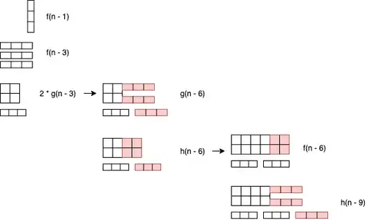

I spent a night on this problem and still can not get the right answer, I feel like I am missing something.
I tried to follow D.W. reasoning and ended up with those relations :
$A0(n) = A0(n - 1) + A0(n - 3) + 2×A2(n - 3)$
$A2(n) = A2(n - 3) + A3(n - 3)$
$A3(n) = A0(n) + A3(n -3)$
Am I wrong in those relations ?
If it's correct I guess it's my way to compute it, but I am too uncertain about those relations right now...
Here a pic to show you my thoughts process (f() would be A0 and g() would be A2 and h() would be A3)
