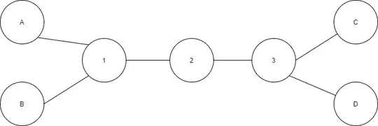

For example, we can have different cases for image below (undirected graph):
  1. If pairs are A-B and C-D, then 2 is not vertex cut, because pairs remain connected.
  2. If pairs are A-C and B-D, then 2 is vertex cut, because pairs can't communicate (there is no path between them).
If we know set of pairs that need to communicate, what is the most efficient way to find all "vertices cuts"? enter image description here
