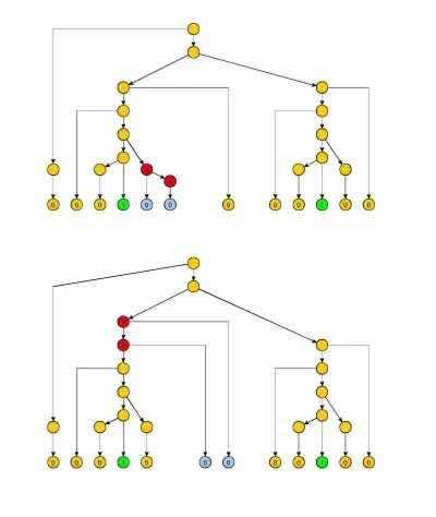

If we restrict our attention to the ways in which the four 1s of $w$ can be generated we have the three cases shown at the top of the figure 1. The central part of the figure 1 shows the first case (but the others are similar).
Figure 1 (the full picture can be downloaded here)
If we pick $a=e, c=2a$ and $b,d \gg a$ we see that the zeros between the two pairs of 1s must be independently pumpable (red nodes in the figure): in particular, for large enough $b \gg a$, we get a duplicate nonterminal node on a internal subtree (node X in figure 2) or a repeated subsequence in the path towards the first or the second 1 (node Y in figure 2). Note that Figure 2 is a little bit simplified: there can be more nonterminal nodes between the two $X$s, and also between the two $Ys$ ($Y\to ... \to Z_i \to ... Y$ but with $Z_i$ that produces only 0s on the right of the first 1).
Figure 2
So we can fix an arbitrary $a = e = k, c = 2a$, then pick large enough $b$ to get an independently pumpable node on the sequence of zeros between first and second $1$. For the sequence of zeros between the third and fourth 1, we can choose $d = b! +b$.
But $0^b$ is independtly pumpable so there is a $p \leq b$ pumpable substring $y$, i.e. such that $b = xyz, |y|=p, |x|\geq 0, |z|\geq 0$ and $xy^iz = b!+b$. The string we get is:
$$w' = 0^k 1 0^{b!+b} 1 0^{2k} 1 0^{b!+b} 1 0^k$$
but $w' \notin L_1$. Thus $L_1$ is not CF and finally $L$ is not CF.
