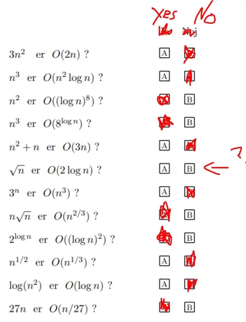

"er" is the Danish equivalent of "is" in English. I need some help with the square root one. Additionally, it would be nice to know if the other ones are correct. enter image description here
You can use this fact that $\log(n) = O(n^k)$ for any constant $k > 0$ and $k \in \mathbb{R}$. $k$ in your case is $\frac{1}{2}$. Hence, $\sqrt{n}$ is not $O(2\log(n))$.
