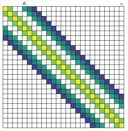

And $Q$ is a $n \times n$ square sparse pairwise transition matrix that looks like: enter image description here
The matrix is symmetric structurally (shown by the colors), but not numerically. It is characterized by 3 tri-bands, with the distance between the bands related to $\sqrt{n}$. If there is a technical term for this matrix, I don't know what it is.
