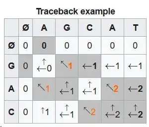

But when I am trying to find out this through LCS matrix which I learnt from this link https://en.wikipedia.org/wiki/Longest_common_subsequence_problem
Based on the explanation and this example given there

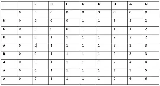

I built this matrix for my case
But my matrix is reaching to the length 6 while it should reach to length 3 only because that is the longest comment sequence of the two strings I am using.
Could anybody please point out the mistake I am doing? I can see the problem is happening because of the extra 3 A's at the end of one of the string.
Look at row=1 and column=8 (using 0 indexed numbers) in your matrix. That value says that the length of LCS between SHINCHAN and N is 2, which is impossible since N itself is of size 1.
When s1[i] and s2[j] are equal you need to look at the number in matrix[i-1][j-1] and add one and not matrix[i][j-1] (which I think you are doing). You can compare your method to the pseudocode written in the wikipedia article to arrive at the correct matrix (copied below for convenience)
