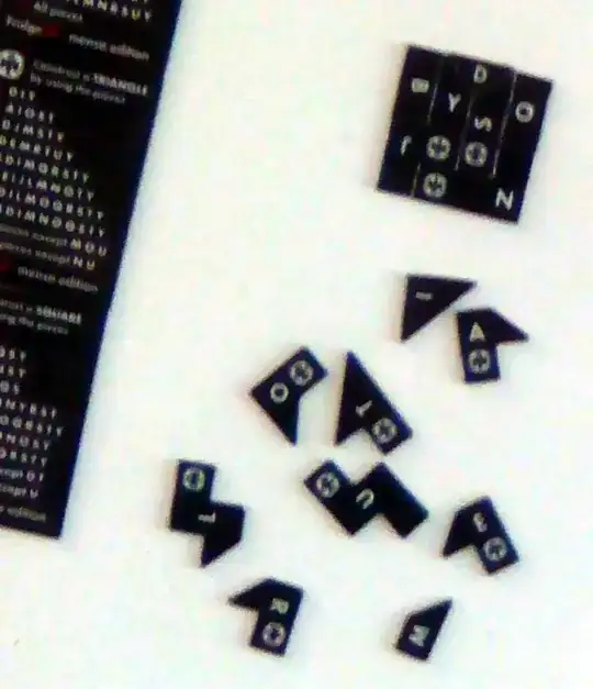

FridgeIQ is a geometric disection puzzle consisting of 16 polygonal tiles as seen in the terrible picture near the bottom of this post
The shapes of the tiles are based on a square grid with the occasional diagonal across one of the grid fields. The total area of all the tiles is 40 such grid units. Each tile is identified by a single unique letter.
In the box comes a set of challenges, each giving a subset of the tiles and a shape to create. For example one challenge is: "construct a square using the tiles BDQSYJN". Which I have done in that picture and I have some left-over tiles that were not part of that particular challenge.

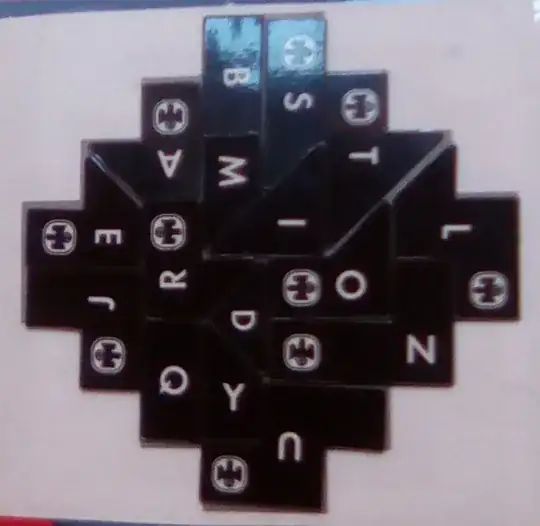

In addition to the standard challenges my friend has presented me with an extra set of target shapes which finally are the point of this question. I have attached another picture showing one of them in solved state.
These extra challenges all use the complete tile set, so their total area is 40 units, and they all have fourfold mirror-symmetry. Not all of them are as simple like the one in the picture, some have a hole or holes, but they are all connected.

Bad photo of FridgeIQ tiles
Solved extra challenge
