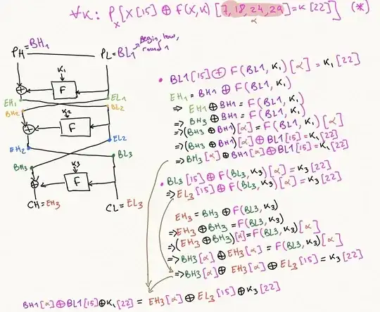

Walking through a linear attack on 3-rounds of DES

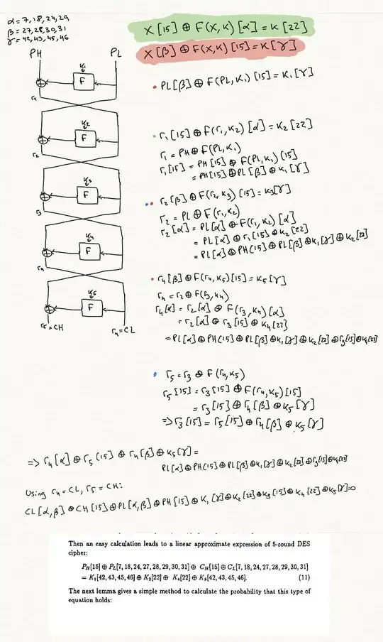

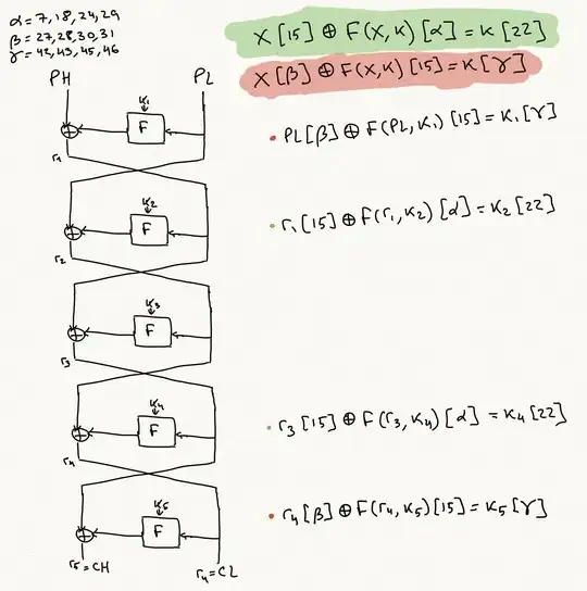

A sketch of 5-rounds of DES and the equations Matsui suggests
My questions are:
  1. How does one use those 4 equations to solve 5-rounds DES? The method I used for 3-rounds doesn't seem to be working.
  2. What conditions does one need for two liner approximations to be concatenable? Alternatively, why does Matsui use two different trails for 5-round DES, instead of just the green one (the first one he finds) like he used for 3-round DES, if the green one has a higher bias than the red one?
  3. In general, how does one extend this sort of attack to $n$-round DES? How does one do this algorithmically for any Feistel cipher?
Thanks!
EDIT: I managed to prove the 5-round approximation, but I honestly don't understand what I did, I just followed equations and some variables disappeared:
Approximation for 5-round DES
I'd love to understand how this works in general. In Matsui's table at the end, he uses approximation trails like "AB-BA". What does this - mean formally, and why can A and B be concatenated both ways?

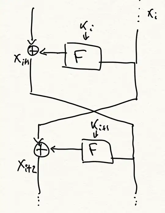

To see what the edges are, say we have a 1-round approximation like this:
$$ x[\alpha] \oplus F(x, k)[\beta] = k[\gamma] \tag{2} $$
We can instantiate it at round, say, $i$, to get:
$$ x_i[\alpha] \oplus F(x_i, k_i)[\beta] = k_i[\gamma] \tag{3} $$
and now we can use the Feistel structure, knowing that $x_{i+1} = x_{i-1} \oplus F(x_i, k_i)$, to rewrite $F(x_i, k_i)$ as $x_{i+1} \oplus x_{i-1}$, and so:
$$ x_i[\alpha] \oplus \left(x_{i+1} \oplus x_{i-1}\right)[\beta] = k_i[\gamma] \tag{4} $$
This will be an edge in our graph. That is, for all linear approximations, and for all instantiation rounds $i$, we can create such an edge. If the source of the edge is equation $(1)$, the target of the edge is the following equation, obtained by $\operatorname{XOR}$ing $(1)$ and $(4)$:
