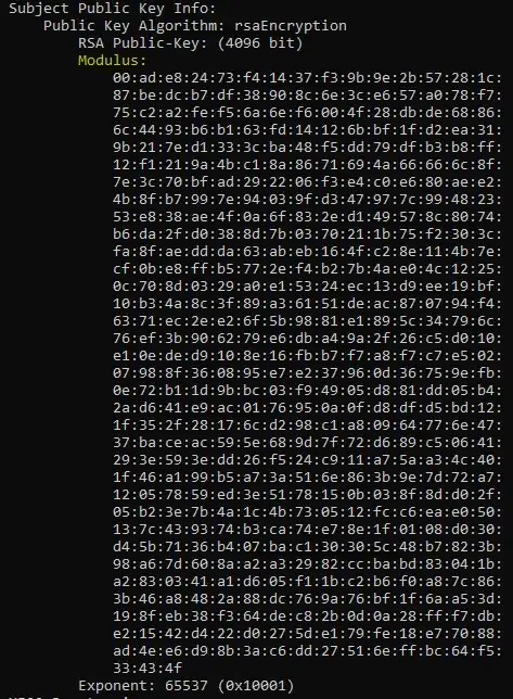

I've exported the root CA cert (ISRG Root X1) used by StackOverflow's digital certificate, as a DER encoded binary X.509 (.cer) file and used openssl in cmd to find out the modulus/exponent:
openssl.exe x509 -in C:\Cert.cer -inform der -text

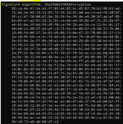

I then did the same thing for the next certificate in the chain which is called R3, to get the signature:
Signature for R3:
I've copied these into C# as byte arrays and am using the following code to decrypt the signature:

            // From ISRG root CA:
            var modulus = new byte[] { 0xad, 0xe8, 0x24, 0x73, 0xf4, 0x14, 0x37, 0xf3, 0x9b, 0x9e, 0x2b, 0x57, 0x28, 0x1c,

            // From R3 intermediate CA:
            var signature = new byte[] { 0x85, 0xca, 0x4e, 0x47, 0x3e, 0xa3, 0xf7, 0x85, 0x44, 0x85, 0xbc, 0xd5, 0x67, 0x78,

rsa.ImportRSAPublicKey(modulus, out bytesRead); is failing with:
System.Security.Cryptography.CryptographicException: 'ASN1 corrupted data.'
AsnContentException: The encoded length exceeds the maximum supported by this library (Int32.MaxValue).
From the comments in the above code, you can see I'm trying another method, however this fails as well.
Is this the correct way to manually decrypt a signature using RSA?
Do I need to specify the exponent somewhere? Or is it assumed to be 65537?
From the docs, the public key should be in the following form:
The bytes of a PKCS#1 RSAPublicKey structure in the ASN.1-BER encoding.
That means it should be a sequence (0x30) of two integers (0x02), where each tag is followed by the length of the data encoded. Here are some examples of the structure: https://crypto.stackexchange.com/a/98513/49392 What is the SSL private key file format?
Note that a public key consists of both the modulus and the exponent (65537). At the moment, you're just trying to use the modulus alone. That is why you need to use the BER structure above to provide both pieces of data.
