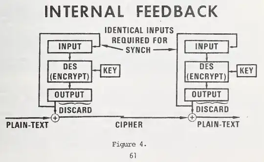

It turns out that with high probability Carl M. Campbell Jr. is the inventor of the OFB mode around 1977. This was the missing point in this answer. Below is the original drawing for OFB mode.
