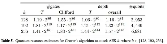

Current estimations for an impelmentation of Grover's algorithm for AES requires much more qubits. According to this paper by Grassl et al. the required number of qubits required for AES-256 is 6681, see the following extracted table:
I guess it's not unreasonable to draw similar conclusions for SHA2-512, which has a much bigger internal state, and say that 1024 qubits are not enough.

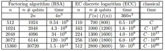

And regarding RSA, there is a paper from Proos and Zalka with estimations for RSA and ECC. See the image below extracted from the paper:
Which clarifies that you need 2048 qubits to factor a 1024 RSA key. As noted by user1147688 in a comment this paper talks about logical qubits, and specifies that:
Also it seems very probable that for large scale quantum computation error correction or full fault tolerant quantum computation techniques are necessary. Then each of our "logical" qubits has to be encoded into several physical qubits (possibly dozens) and the logical quantum gates will consist of many physical ones.
Making the target number of qubits to break RSA-1024 much higher than the theoretical 2048.
