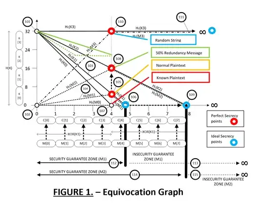

Firstly, with regards to a closed system that is a pure cipher, the security of a cipher is dependent on two things only. The starting entropy (size) of the system as a whole (keys * nonces) and the redundancy of the language used in the message. With these two quantities you can calculate how much ciphertext needs to be intercepted to successfully benefit from a key or message brute force attack.
This can be plotted on a logarithmic graph for visual analysis and simple additive manipulation.
Equivocation (Conditional Entropy) Graph
The graph above shows plots for the characters (x axis) in 4 different types of messages against a 32 bit key (y axis).
  • K0,M0 - Conditional entropy of known plaintext
  • K1,M1 - Conditional entropy of "normal" plaintext
  • K2,M2 - Conditional entropy of "50% Redundancy" plaintext
  • K3,M3 - Conditional entropy of "random" plaintext
The length of the intercepted ciphertext required for a successful key or message brute force is related to the amount of redundancy in the message.
Looking at K1 and M1 we see the conditional entropy of a "normal" message. We know that various languages on average have massive amounts of redundancy, over 80%. So with AES-256 you divide key entropy by redundancy 256/0.8 = 320. This means that you only need 40 bytes of AES-256 to break it under brute-force attack. The 320-bit indicates the unicity point on the graph. the point where message equivocation = 0 (2^0 = 1). Where a single valid result will occur when the last candidate ciphertext is eliminated.
