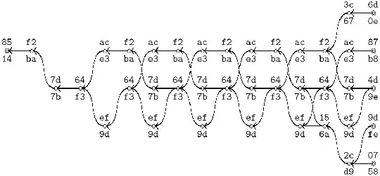

My favorite example of why we should not trust security claims based on repelling existing attacks is the ISO/IEC 9796:1991 signature scheme, withdrawn 2000. It was AFAIK the first official standard for RSA signature, and carefully justified by Louis Claude Guillou, Jean-Jacques Quisquater¹, Mike Walker, Peter Landrock, Caroline Shaer Precautions taken against various potential attacks in ISO/IEC DIS 9796 “Digital signature scheme giving message recovery”, in proceedings of Eurocrypt 1990. And then, in 1999, that scheme was broken by Don Coppersmith, Shai Halevi, and Charanjit S. Jutla extending an almost working attack by Jean-Sébastien Coron, David Naccache, and Julien Stern; and independently by me using a technique a child could apply: all there is to do is find two different paths across this maze and collect the node values. 9796 maze
