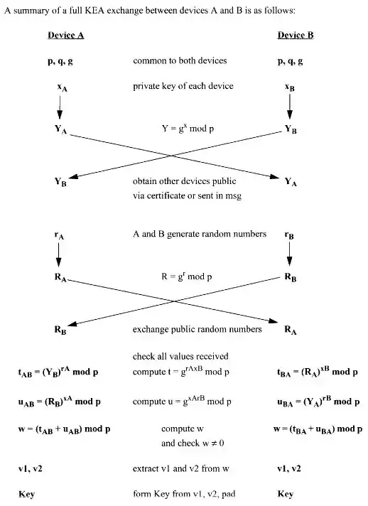

Wikipedia is wrong in this case - just like the NIST publication describing SKIPJACK already implies by being titled "SKIPJACK and KEA Algorithm Specifications". In fact, on page 17 of that paper, you will find infos about KEA exchange for Email and on page 12, there's a summary of a full KEA exchange between devices A and B…
A summary of a full KEA exchange between devices A and B (page 12)

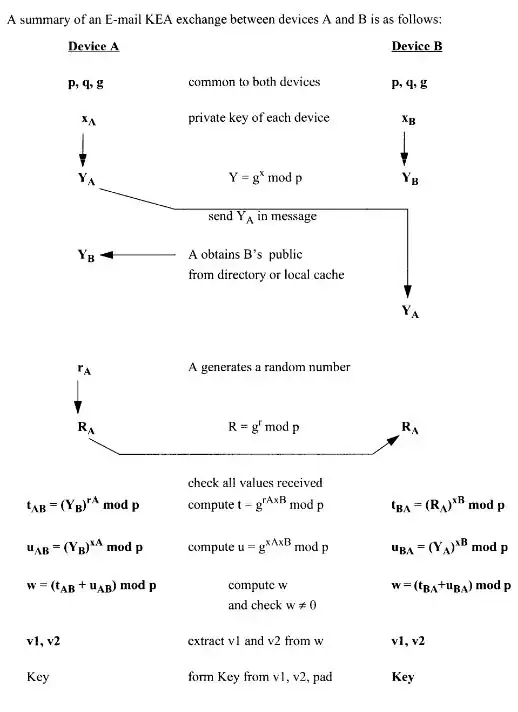

A summary of an Email KEA exchange between devices A and B (page 17)
