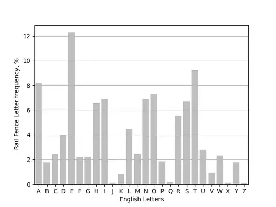

As you found out that the ciphertext has a similar frequency to the English letter frequency. This can lead to lots of possibilities
  1. It can be a shift cipher, that is the generalization of the Caesar cipher $$c = m + k \bmod 26.$$ In the Caesar cipher, the $k=3$ is fixed. There are at most 26 candidates to test, not so far.
  2. It can be a permutation cipher, that is there is a permutation $\pi$ on the alphabet that permutes the letters. The 1000 years old frequency attack work on this. You need to swap the top three letters and try to reveal some other. Since you have a long message this should be working very well. Actually, the substitution cipher is also a permutation cipher.
  3. It can be any of the transposition ciphers since they are keeping the letter frequency, too.
    1. Rail fence cipher
      Try some possible rail lengths. It is a very weak cipher. The below is the Rail Fence histogram with rail size 3. This is exactly the same as Moby Dick's frequency since the letters are not permuted, just the positions changed. The same applies other transposition ciphers since they just transpose.

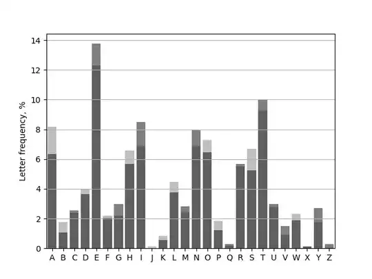

I also did;
The light gray is from the Moby Dick text, the medium grey is your text. In a bar, a light grey on the top means that moby dick has a higher frequency, a medium grey on the top means that your text higher frequency, a sample Python code, and Moby Dick is here.
From here we can simply say that it cannot be Caesar or Shift Cipher since the frequency is very close to the real English frequency!.
