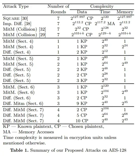

There is a paper called Low Data Complexity Attacks on AES by Bouillaget et al. It describes best attacks on 1-4 rounds of AES with only 1-9 known/chosen plaintexts:
Low Data Attacks
So, to answer your question: 1 round can be attacked in $2^{32}$ time with 1 known plaintext, and in $2^{12}$ time with 2 known plaintexts.
