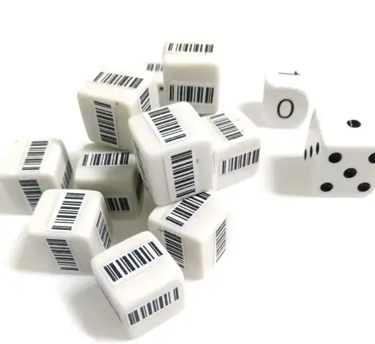

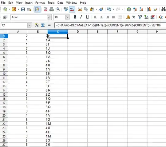

Create some six-sided dice with bar codes, numbered 1 to 6. Find a bar code scanner. Use OpenOffice Calc or a similar program with the function that you see in the picture above (or alter it as you see fit with whatever works). As you scan the dice, the document will populate Column A. Stop and populate Column B. The one-time pad values will pop up in Column C. With thirty or so dice, a shoe box with a cover, lots of shaking, and a hand-held bar-code scanner, you can generate pad material faster than rolling dice.

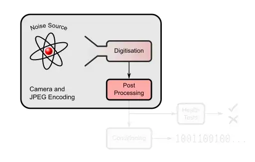

Take 63 photos a blank wall in a very dark room. This seems like a lot, but isn’t. It’s just 63 consecutive presses of the shutter. Say 5 minutes. Try to get the lighting so that the entire view finder is illuminated i.e all pixel values > 0. If you have ISO control, turn that up to the max. It's 99% pure entropy from the many types of noise within all CMOS camera sensors. The cheaper the camera, the better. You simply consider the JPEG encoding of the sensor's image as the post processing component of NIST's generic TRNG architecture, as:-
generic
You then treat it as a bit fixing, block entropy source. There will be no semantic content within the image, so it's just the efforts of the JPEG algorithm to capture the noise. And that's essentially quantum noise, just like the best laboratory phase based TRNGs. Typically I would then measure it's entropy with a compression algorithm like cmix, but that'll take hours (so I haven't), and you only need 4000 bytes. You can be confident that the image contains >> 4000 bytes of entropy within any decent camera frame as there's nothing else. The piling up lemma will deal with that. You don't have to open the image raster, just use the raw .jpg.
And then use your favourite programming language to do $ \operatorname{SHA-512}(jpg_i) $ in a loop of 63 file hashes and concatenations. Or do cat jpg_i | sha512sum >> my_letters 63 times which is not as monotonous as it sounds with automatic consecutive image numbering and command recall.
This online TRNG uses this technique.

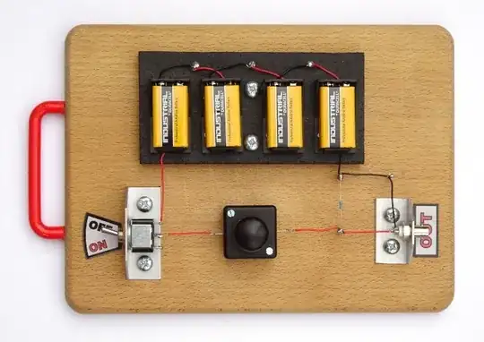

Acquire a Zener diode (now £11! due to global semiconductor shortage) , some batteries and a hammer. Don’t laugh – it works perfectly. Build something like:-
breadboard
and plug it into an Arduino’s analogue to digital converter. There will be lots of quantum Avalanche noise created (>1Vpp). The Arduino then just forwards the raw samples to a PC for you to follow the hash based extraction procedure described above. This time you’ll have to use cmix (or equivalent) to measure the entropy rate to ensure that you’re hashing more than 1024 bits of entropy. That's to be in lock-step with NIST’s definition of ‘full’ entropy. I use a safety factor of 3, so hash 3072 bits each time. A little C programming will be required, but Arduino’s are used in schools.
cmix details here, and it's greedy for RAM.
I recommend option 1 for zero effort, but option 3 for maximum fun. And option 3 is not limited to 4000 characters of course.
