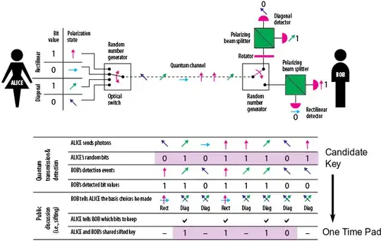

OTPs are making quite a resurgence these days as a fundamental product of quantum key distribution networks using the BB84 protocol. It's worth explaining where the OTP fits in with that protocol. Consider the following arrangement:-
otp
Alice has a photonics based true random number generator (an essential component of OTPs) . Those bits randomly select polarised photons /qubits passing to Bob, forming a candidate key. The candidate key is received, error corrected and sifted reducing its length. What remains is a key known to both Alice and Bob suitable for future OTP work.
When QKD was developed, the sifted key transmission rate was only a few kbps so the key was used as a conventional symmetric key for external speed enhancement. Things have moved on and generation rates are of the order of 1Mb/s. Field test of quantum key distribution in the Tokyo QKD Network details a working secure video conferencing system in Tokyo running entirely via OTPs. The paper also details work on secure OTP based smart phones. This is another (NIST) video surveillance system based on OTPs.
And the Tokyo paper was published in 2011. The equipment will have shrunk and improved and the exchange protocols will have been refined. OTPs will inevitably become more commonplace, especially given the allure of information theoretic security.

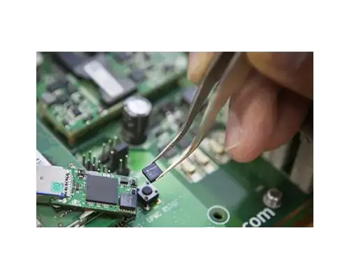

To the counter; since a lot of hardware is required including true random number generators, OTPs are not really suitable for the consumer yet. 8K UHD movies are not currently the best use case for OTPs. But who can predict the future? A Netflix QKDN? A lot of people have fibre to the premises, so it's feasible. And a true random generator can fit into tweezers as does the Swiss chip below:-
