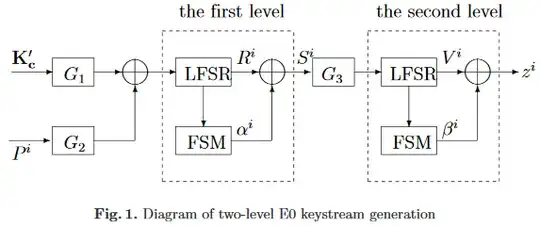

I thought like encrypting an IV concatenated with a CTR but instead of XOR-ing this output with the plaintext this output should be used as a temporary key for another encryption block that actually converts the plain- to ciphertext. In other words in a regular CTR mode of operation the XOR would be replaced by a full encryption algorithm and the OTP would be its key.
Balazs F
  • 31
There are some ciphers which do this, most notably E0, a 128-bit stream cipher based on four LFSRs that is used in older versions of the Bluetooth protocol. As vulnerabilities have been found in E0, a scheme was devised to reduce the security impact called two-level E0. Normally, the cipher encrypts 2745 bits (one Bluetooth frame) at a time. With two-level E0, every 128 bits of the keystream is used to seed another instance of E0 which generates only 2745 bits of keystream from that key.
two-level e0
Note that this is not a special mode of encryption, but the use of true stream ciphers. This difference is minor, as counter mode is merely a way to convert a block cipher into a stream cipher. Most block ciphers (and many stream ciphers) have a key schedule, which is an expensive setup phase whenever a new key is used, making it impractical to frequently switch keys. The stream cipher E0 does not have a complicated key schedule. The 128-bit key is used directly as the cipher's inner state (specifically, it is split up into 25, 31, 33, and 39 bits, each of which is used as the initial state for each of the cipher's four LFSRs). This allows it to change keys frequently without a significant performance impact.
Please note that E0, even two-level E0, is not a particularly secure cipher. The key must be changed very regularly or known-plaintext attacks can allow for key recovery. These weaknesses stem from both problems in the design of two-level E0, as well as the fact that E0 is built off of LFSRs, which are non-cryptographic algorithms. Using AES in CTR mode will be far more secure than any type of E0.

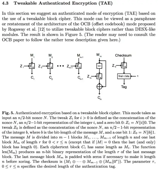

Your proposed mode is:
$$ C_i = E_{E_k(\mathrm{IV} || i)}(P_i) $$
... where $E_k(m)$ is the block cipher application with key $k$ to input block $m$, $i$ is the block counter, and $C_i$ and $P_i$ are the $i$th ciphertext and plaintext blocks respectively.
To me this bears resemblance to modes for tweakable block ciphers (TBCs), an extended type of block cipher that in addition to the conventional key and message inputs also take a per-encryption tweak argument. (See the linked Q&A.)
In the Liskov, Rivest and Wagner paper that introduced the notion of tweakable block ciphers, we find this mode:
From Liskov, Rivest and Wagner
As the legend explains, the $Z_i$ values that are being used as tweaks to the cipher are IV/counter concatenations. On the left half of the diagram, the message blocks other than the last one are being encrypted by applying the TBC directly to them. (The rest of the diagram shows the last message block being encrypted by a kind of stream cipher, and the computation of an authentication tag.)
We could take your idea of deriving a key for each message block by encrypting an IV and block counter with a master key and think of refactoring it into a construction of a TBC $E^T_k$ out of a conventional block cipher $E'_k$:
$$ E^T_k(m) = E'_{E'_k(T)}(m) $$
I don't know if that is a secure TBC, but the paper offers this construction that doesn't need to rekey the underlying block cipher (an operation that's expensive with many ciphers):
$$ E^T_k(m) = E'_k(T \oplus E'_k(m)) $$
Refactoring your mode to use that construction we'd get something like:
$$ C_i = E'_k(IV || i \oplus E'_k(P_i)) $$
And it seems to me any chosen-plaintext attack on the confidentiality of this simpler mode would imply a corresponding attack on TAE, so the security of TAE would imply the confidentiality of this mode.
