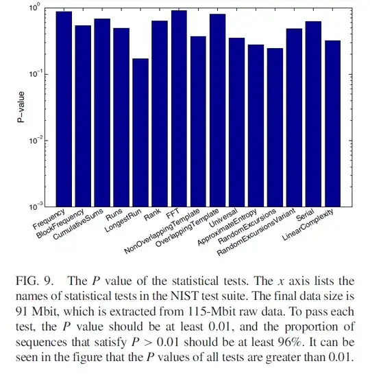

Regarding the Non-Overlapping Template test, this test normally gives us a bunch of p-values (148 values). I would like to ask that how do we interpret those values into a single p-value for presenting in an academic report. I have seen many papers illustrate as only a single p-value. For example, Cao et.al, Phys.Rev X,6 2016
Cao et.al, Phys.Rev X 6, 2016
In this work the p-value of Non-Overlapping Template test is shown as a single value. I have tried using fisher method to combine all of the p-values but by it's characteristic, the p-value after a combination drops exponentially. Is there any simple way to interpret ?

As you're dealing with randomness, the test results have randomness within them too. So combinatoric tests have to be statistically based. I've never seen Fisher used for this in the common randomness tests. By definition, $p$ is uniformally distributed 0 to 1 for the null hypothesis, ie. data is properly random. A common technique is for a Kolmogorov–Smirnov (KS) test against the expected uniform distribution. The test then outputs a single $p$ value for uniformity and thus data randomness. Hope for $p > 0.01$.
I only ever generate enough data for Diehard testing, but you see this approach used therein. For example, the 3D Spheres test consolidates 20 $p$ values into one:-

You can also see it being used in the following NIST results snippet taken from a NIST random excursion results Q & A which is talking about their interpretation:-
  9   3   6   5  10   8   7   7   8   8  0.808725     70/71      RandomExcursionsVariant
  6   5   5   8  10   8   7   9   5   8  0.901761     69/71      RandomExcursionsVariant
  3   9   5  12   6   6   6  10   8   6  0.437274     71/71      RandomExcursionsVariant
  3   6   7   2  10  11   6  10   7   9  0.238562     71/71      RandomExcursionsVariant
  4  10   6  12   3  13   4   4   5  10  0.033552     71/71      RandomExcursionsVariant
The decimal number (e.g. 0.808725) is a KS test performed over 9 3 6 5 10 8 7 7 8 individual scores where one failed with $p$ < 0.01. The NIST SP 800-22 software does this amalgamation automatically.
You should be able to adapt this technique to the 148 values of your NIST Template test if the program didn't produced them already. Spreadsheets and standard programming libraries can help.
