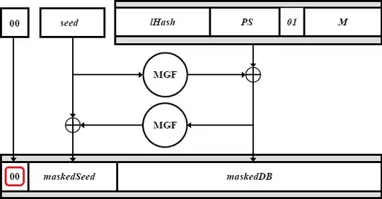

The attack is exposed in James Manger's A Chosen Ciphertext Attack on RSA Optimal Asymmetric Encryption Padding (OAEP) as Standardized in PKCS #1 v2.0 (in proceedings of Crypto 2001). It exploits an RSA decryption system that leaks a little information about $y=x^d\bmod N$ for $x$ repeatedly chosen by an attacker.
The applied part of the attack focuses on the leak of if $y<2^{8k-8}$ with $N$ of $8k-7$ to $8k$ bit; or equivalently: does $y$ start with a 0x00 byte when expressed as a big-endian bytestring of $k$ bytes, as it should in RSAES-OAEP padding:
OAEP
In PKCS#1 v2 7.1.2 (Decryption operation) step 4, that 0x00 is verified thru the use of "length $k-1$" in:
Convert the message representative $m$ to an encoded message $\text{EM}$ of length $k-1$ octets: $\text{EM}=\text{I2OSP}(m,k-1)$
If I2OSP outputs "integer too large," then output "decryption error" and stop.
PKCS#1v2 has a note stating that the above "decryption error" must be identical to one that can occur on failure of another redundancy check made after OAEP's masking is undone.
Manger observed that not all implementations do this properly; and those that do as instructed take less time when that test fails (due to the stop, the rest of the rest of the procedure is not performed, saving time), thus timing can reveal the desired bit of information.
This is addressed in PKCS#1 v2.1 (and PKCS#1 v2.2, identical in this regard) by using $\text{I2OSP}(m,k)$ without the $-1$, which outputs an extra additional byte $Y$ and never triggers an error. $Y$ is tested in the end, together with other redundancy criteria applying to the message after OAEP unmasking.
If there is no octet with hexadecimal value 0x01 to separate $\text{PS}$ from $M$, if $\text{lHash}$ does not equal $\text{lHash’}$, or if $Y$ is nonzero, output "decryption error" and stop.
Note. Care must be taken to ensure that an opponent cannot distinguish the different error conditions in (the above), whether by error message or timing, or, more generally, learn partial information about the encoded message EM. Otherwise an opponent may be able to obtain useful information about the decryption of the ciphertext, leading to a chosen-ciphertext attack such as the one observed by Manger.
All versions of RSAES-OAEP in PKCS#1v2.0, 2.1 and 2.2 are interoperable, and the procedures described lead to identical results, except that their timing variation is less likely to leak information in 2.1 and later.

The RSAES-OAEP scheme in PKCS1 v2.0, v2.1 and v2.2 (rfc2437, rfc3447, rfc8017 respectively) is the same scheme, although the notation changed between 2.0 and 2.1; see why did oaep change from pkcs1 v2.0 and v2.1? and https://stackoverflow.com/questions/42709020/is-there-a-default-label-for-the-built-in-rsa-oaep-encryption-in-java . This scheme is slightly different from (not interoperable with) the one originally proposed by Bellare & Rogaway.
The JCA API does not allow for returning any indication of the RSA-decrypted but still-padded value being < $2^{(nsize-detectable)}$ so there can't be an explicit oracle. The BC implementation of unpadding in org.bouncycastle.crypto.encodings.OAEPEncoding obviously tries to be constant-time and I don't see anything they missed. However, the underlying RSA 'core' (which is org.bouncycastle.crypto.engines.RSABlindedEngine to defend against timing or sidechannel there) does indirectly put the result in a BigInteger temporarily, which might give some timing signal, although I think only very rarely for the (round-binary) keysizes commonly used, because the value must have top 32 bits zero not just 8. You could try testing it if you want to be sure.
Of course this only matters if the attacker can receive the signal; if they're local (on the same machine) there are usually several possibilities, but if they're remote it can only work if you (always) give a prompt visible response to every purported ciphertext (good or bad).
Also, as Maarten commented, using the JVM default charset for encoding and decoding is a good way to get your data corrupted, at least intermittently, though not a security issue.
