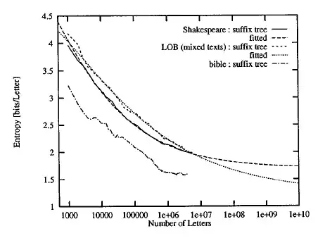

Note 1. This subtle distinction in entropy definitions will cause us all problems. Some commentators will suggest that your strings do not have any entropy whatsoever, in contrast with accepted information theory and Shannon himslef. A good example of entropy measures of fixed text is this entropy rate graph from Thomas Schürmann and Peter Grassberger, Entropy estimation of symbol sequences.
