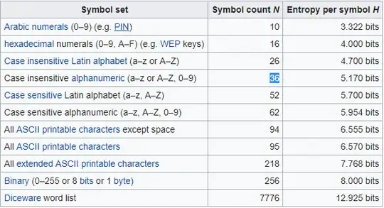

I read this wiki article and saw this formula for random password's information entropy. Also the wiki article mention that the symbol count for non case sensitive is 36. Is there a way I can calculate the password space with this information.Entropy per symbol for different symbol sets random password's information entropy
The choice of 8 fully random characters is exactly 3 bits as $\log_2(8) = 3$. So to calculate the strength in bits you simply multiply with the size of the password: e.g. 16 * 3 = 48 bits of strength for 16 characters.
To translate that to the password space - the number of possible passwords - you simply can perform $2^{48}$ which means that there are 281,474,976,710,656 possible passwords. A little known trick to get an idea of the number of decimal digits is to multiply by 3 and then divide by 10 and round up: so $\large\lceil\normalsize{48 * 3 \over {10}}\large\rceil\normalsize = 15$, i.e. above number contains 15 digits. A more direct method is to simply perform exponentiation with the password size: $8^{16}$ will give you the same large number. However, I use the trick above to perform such calculations without calculator.

The trick above depends on a little known constant: 3.3219280948873626. This is the result of $\ln(10)\over\ln(2)$, i.e. each decimal digit takes about 3.3219280948873626 bits to be represented. It's quite close to 3.3333 wich makes calculations rather efficient. The little difference makes it so that $2^{10} = 1024$, or just over a thousand (a kilo in ancient Greek).

You can't easily calculate the entropy of a human-generated password. I'm talking about human-generated passwords, not machine-generated encryption keys. This is a hugely important distinction that people often miss.
It's tempting to use the H log formula that you've included at the bottom of your question. That only applies to independently and identically distributed (IID) characters. That's what a key derivation function provides, and which you such probably be considering. A human password is like "SECRET" and "JamesBond1" as I use. Those characters are not remotely IID.

A key of 8 IID characters chosen from an alphabet of 26 has exactly $ log_2 $(26) x 8 = 37.6 bits of entropy. Or $ \approx 2 \times 10^{11}$ (~200 billion) possibilities.
